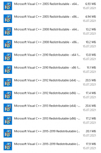

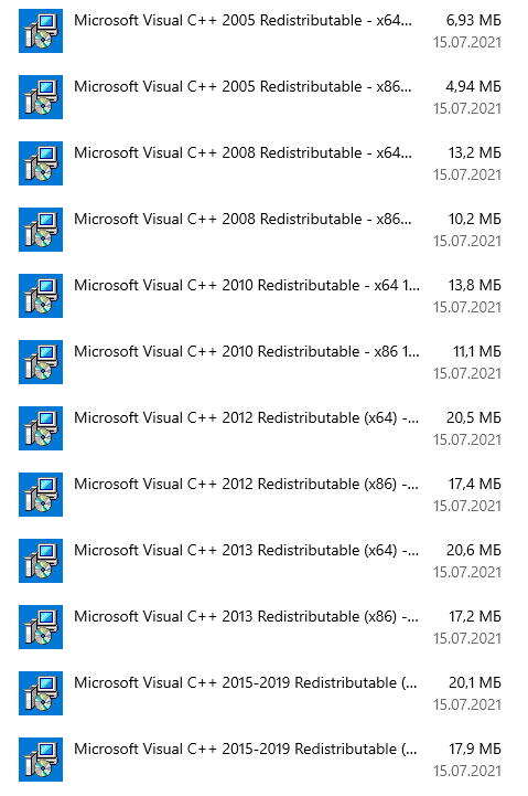

Установил последний OpenServer, MSVC++ тоже, все равно падает MySQL
2021-07-16T03:49:02.118024Z 0 [System] [MY-010116] [Server] c:\openserver\modules\database\MySQL-8.0-Win10\bin\mysqld.exe (mysqld 8.0.24) starting as process 4212 2021-07-16T03:49:02.127609Z 1 [System] [MY-013576] [InnoDB] InnoDB initialization has started. 2021-07-16T03:49:16.322261Z 1 [System] [MY-013577] [InnoDB] InnoDB initialization has ended. 2021-07-16T03:49:20.941621Z 0 [System] [MY-010931] [Server] c:\openserver\modules\database\MySQL-8.0-Win10\bin\mysqld.exe: ready for connections. Version: '8.0.24' socket: '' port: 3306 MySQL Community Server - GPL. 03:50:03 UTC - mysqld got exception 0xc0000005 ; Most likely, you have hit a bug, but this error can also be caused by malfunctioning hardware. Thread pointer: 0x23729253940 Attempting backtrace. You can use the following information to find out where mysqld died. If you see no messages after this, something went terribly wrong... 7ff7f675081a mysqld.exe!?cleanup_arrays@Item_func_in@@AEAAXXZ() 7ff7f674d658 mysqld.exe!??1Item_func_in@@UEAA@XZ() 7ff7f674e3b4 mysqld.exe!??_9Item@@$BDJI@AA() 7ff7f67bc2ee mysqld.exe!?free_items@Query_arena@@QEAAXXZ() 7ff7f6a6f883 mysqld.exe!??4?$List@ULEX_USER@@@@QEAAAEAV0@AEBV0@@Z() 7ff7f68d6333 mysqld.exe!??1sp_head@@AEAA@XZ() 7ff7f68d7444 mysqld.exe!?destroy@sp_head@@SAXPEAV1@@Z() 7ff7f6a4f771 mysqld.exe!??$_Free_non_head@V?$Malloc_allocator@U?$_List_node@U?$pair@$$CBV?$basic_string@DU?$char_traits@D@std@@V?$allocator@D@2@@std@@V?$unique_ptr@Vsp_head@@Usp_head_deleter@sp_cache@@@2@@std@@PEAX@std@@@@@?$_List_node@U?$pair@$$CBV?$basic_string@DU?$char_traits@D@std@@V?$allocator@D@2@@std@@V?$unique_ptr@Vsp_head@@Usp_head_deleter@sp_cache@@@2@@std@@PEAX@std@@SAXAEAV?$Malloc_allocator@U?$_List_node@U?$pair@$$CBV?$basic_string@DU?$char_traits@D@std@@V?$allocator@D@2@@std@@V?$unique_ptr@Vsp_head@@Usp_head_deleter@ 7ff7f6a50463 mysqld.exe!?sp_cache_clear@@YAXPEAPEAVsp_cache@@@Z() 7ff7f67bb16c mysqld.exe!?cleanup@THD@@AEAAXXZ() 7ff7f67bd9a5 mysqld.exe!?release_resources@THD@@QEAAXXZ() 7ff7f67664e4 mysqld.exe!?modify_thread_cache_size@Per_thread_connection_handler@@SAXK@Z() 7ff7f7b7dbe1 mysqld.exe!?set_compression_level@Zstd_comp@compression@transaction@binary_log@@UEAAXI@Z() 7ff7f7761d1c mysqld.exe!?my_thread_join@@YAHPEAUmy_thread_handle@@PEAPEAX@Z() 7ff8b7b31bb2 ucrtbase.dll!_configthreadlocale() 7ff8b87b7034 KERNEL32.DLL!BaseThreadInitThunk() 7ff8ba422651 ntdll.dll!RtlUserThreadStart() Trying to get some variables. Some pointers may be invalid and cause the dump to abort. Query (0): Connection ID (thread ID): 18 Status: KILL_CONNECTION The manual page at http://dev.mysql.com/doc/mysql/en/crashing.html contains information that should help you find out what is causing the crash.
Такое ещё бывает из-за битых баз, пытался их с другой MySQL выцепить и частично перенести в папку с данными?Vormit писал(а): ↑16 июл 2021, 07:15 03:50:03 UTC - mysqld got exception 0xc0000005 ;
terribly wrong...
