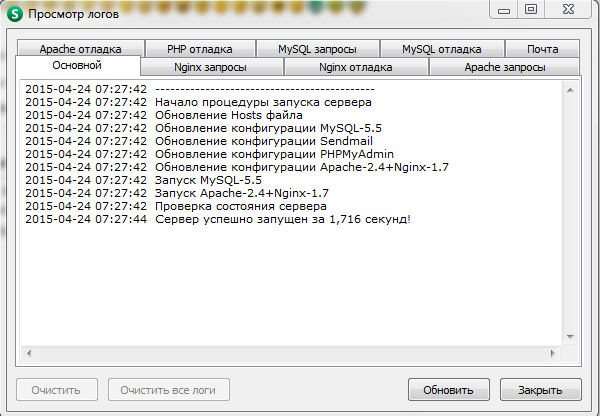

Проверка состояния сервера Не удалось запустить PHP-5.3.27-nts Сбой запуска! [Mon Mar 31 22:23:52 2014] [warn] Init: Session Cache is not configured [hint: SSLSessionCache] [Mon Mar 31 22:23:52 2014] [warn] RSA server certificate CommonName (CN) `openserver' does NOT match server name!? [Mon Mar 31 22:23:52 2014] [warn] RSA server certificate CommonName (CN) `openserver' does NOT match server name!? [Mon Mar 31 22:23:52 2014] [warn] Init: Name-based SSL virtual hosts only work for clients with TLS server name indication support (RFC 4366) [Mon Mar 31 22:23:53 2014] [warn] RSA server certificate CommonName (CN) `openserver' does NOT match server name!? [Mon Mar 31 22:23:53 2014] [warn] RSA server certificate CommonName (CN) `openserver' does NOT match server name!? [Mon Mar 31 22:23:53 2014] [warn] Init: Name-based SSL virtual hosts only work for clients with TLS server name indication support (RFC 4366) [Mon Mar 31 22:23:53 2014] [notice] mod_bw : Memory Allocated 0 bytes (each conf takes 40 bytes) [Mon Mar 31 22:23:53 2014] [notice] mod_bw : Version 0.92 - Initialized [0 Confs] [Mon Mar 31 22:23:53 2014] [notice] mod_bw : Supported resolution for Timers [ Min: 1 Max: 1000000 ] [Mon Mar 31 22:23:53 2014] [notice] mod_bw : Enabling High resolution timers [ 1 ms ] [Mon Mar 31 22:23:53 2014] [notice] Apache/2.2.25 (Win32) mod_ssl/2.2.25 OpenSSL/0.9.8y mod_fcgid/2.3.7 mod_bw/0.92 configured -- resuming normal operations [Mon Mar 31 22:23:53 2014] [notice] Server built: Jun 29 2013 16:08:05 [Mon Mar 31 22:23:53 2014] [notice] Parent: Created child process 3868 [Mon Mar 31 22:23:53 2014] [notice] Disabled use of AcceptEx() WinSock2 API [Mon Mar 31 22:23:53 2014] [warn] Init: Session Cache is not configured [hint: SSLSessionCache] [Mon Mar 31 22:23:53 2014] [warn] RSA server certificate CommonName (CN) `openserver' does NOT match server name!? [Mon Mar 31 22:23:53 2014] [warn] RSA server certificate CommonName (CN) `openserver' does NOT match server name!? [Mon Mar 31 22:23:53 2014] [warn] Init: Name-based SSL virtual hosts only work for clients with TLS server name indication support (RFC 4366) [Mon Mar 31 22:23:53 2014] [warn] RSA server certificate CommonName (CN) `openserver' does NOT match server name!? [Mon Mar 31 22:23:53 2014] [warn] RSA server certificate CommonName (CN) `openserver' does NOT match server name!? [Mon Mar 31 22:23:53 2014] [warn] Init: Name-based SSL virtual hosts only work for clients with TLS server name indication support (RFC 4366) [Mon Mar 31 22:23:53 2014] [notice] mod_bw : Memory Allocated 0 bytes (each conf takes 40 bytes) [Mon Mar 31 22:23:53 2014] [notice] mod_bw : Version 0.92 - Initialized [0 Confs] [Mon Mar 31 22:23:53 2014] [notice] mod_bw : Supported resolution for Timers [ Min: 1 Max: 1000000 ] [Mon Mar 31 22:23:53 2014] [notice] mod_bw : Enabling High resolution timers [ 1 ms ] [Mon Mar 31 22:23:53 2014] [notice] Child 3868: Child process is running [Mon Mar 31 22:23:53 2014] [notice] Child 3868: Acquired the start mutex. [Mon Mar 31 22:23:53 2014] [notice] Child 3868: Starting 32 worker threads. [Mon Mar 31 22:23:53 2014] [notice] Child 3868: Listening on port 443. [Mon Mar 31 22:23:53 2014] [notice] Child 3868: Listening on port 80.
D:\OpenServer\userdata\temp>"D:\OpenServer\modules\database\MySQL-5.1.71\bin\mys qld.exe" --defaults-file="D:\OpenServer\userdata\temp\config\my.ini" --user=root --standalone --console 140331 22:28:46 [Note] Plugin 'FEDERATED' is disabled. 140331 22:28:46 InnoDB: Initializing buffer pool, size = 20.0M 140331 22:28:46 InnoDB: Completed initialization of buffer pool 140331 22:28:46 InnoDB: Started; log sequence number 0 9509956 140331 22:28:47 [Note] Event Scheduler: Loaded 0 events 140331 22:28:47 [Note] D:\OpenServer\modules\database\MySQL-5.1.71\bin\mysqld.ex e: ready for connections. Version: '5.1.71-community-log' socket: '' port: 3306 MySQL Community Server (GPL) 140331 22:28:56 [Note] D:\OpenServer\modules\database\MySQL-5.1.71\bin\mysqld.ex e: Normal shutdown 140331 22:28:56 [Note] Event Scheduler: Purging the queue. 0 events 140331 22:28:56 InnoDB: Starting shutdown... 140331 22:28:57 InnoDB: Shutdown completed; log sequence number 0 9509956 140331 22:28:57 [Note] D:\OpenServer\modules\database\MySQL-5.1.71\bin\mysqld.ex e: Shutdown complete Завершить выполнение пакетного файла [Y(да)/N(нет)]? n D:\OpenServer\userdata\temp>PAUSE Для продолжения нажмите любую клавишу . . .
2014-10-09 19:14:28 -------------------------------------------- 2014-10-09 19:14:28 Начало процедуры запуска сервера 2014-10-09 19:14:28 Обновление Hosts файла 2014-10-09 19:14:28 Обновление конфигурации MySQL-5.5 2014-10-09 19:14:28 Обновление конфигурации Sendmail 2014-10-09 19:14:28 Обновление конфигурации PHP-5.3.27-nts 2014-10-09 19:14:28 Обновление конфигурации PHPMyAdmin 2014-10-09 19:14:28 Обновление конфигурации Apache-2.2 2014-10-09 19:14:28 Запуск MySQL-5.5 2014-10-09 19:14:28 Запуск Apache-2.2 2014-10-09 19:14:28 Проверка состояния сервера 2014-10-09 19:14:50 Не удалось запустить Apache-2.2 2014-10-09 19:14:50 Сбой запуска! 2014-10-09 19:14:50 -------------------------------------------- 2014-10-09 19:14:50 Начало процедуры остановки сервера 2014-10-09 19:14:50 Остановка системных модулей 2014-10-09 19:14:51 Отключение виртуального диска 2014-10-09 19:14:51 Веб-сервер успешно остановлен!
